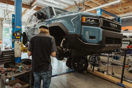

This 2025 Toyota Land Cruiser Base came into the shop for a balanced upgrade that would add clearance, fit larger tires, and bring a tougher stance without overcomplicating things.
Westcott Designs Preload Collar Lift​
We installed a Westcott Designs preload collar lift kit to raise the Land Cruiser about 2–3 inches. This simple but effective lift levels the stance, increases ground clearance, and provides the room needed to run 33-inch tires. A full alignment followed to make sure everything tracked properly with the new setup.

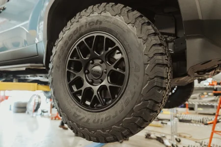

KMC Hatchet Wheels​
The 17x8.5 KMC Hatchet wheels in matte black with a +25 offset were chosen for their strength and bold styling. They sit perfectly under the Land Cruiser, complementing the body lines while keeping clearance where it’s needed.
BFGoodrich KO2 Tires​
We mounted BFGoodrich KO2 all-terrain tires in 285/70R17 (C load). Known for their durability and balanced performance, the KO2s provide traction both on and off-road while maintaining a quiet, comfortable ride. They’re a proven option for Land Cruiser builds.
Final Setup​
With extended tuner lug nuts securing the package, the combination of the Westcott lift, KMC Hatchet wheels, and KO2 tires transformed this Land Cruiser. The stance is leveled, clearance is improved, and it’s ready for both long road trips and weekend trails.
