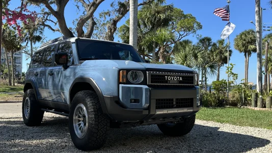

I’m added 285/75R18s to mine with a Westcott Designs Pre Collar kit to make sure I cleared. These Nitto Recons have better sidewall and grip without sacrificing daily comfort.
Any rubbing with those sizes? MPG hit? If anyone’s gone to 17s, curious what wheel specs you used and whether it cleared the calipers.
