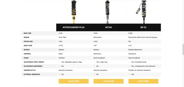

Here's the differences between the 3 OME shocks from their website for anyone wanting to compare.
