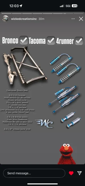

Some super exciting news. We're taking the LT250 build to the next level and upgrading the rear end. Wicked Creations has my LC250 currently and is getting ready to fab up a 3 Linked Cantilever. It will have 8" Coilovers and Bypasses on each corner (front & rear) as well as 2.0 bump stops. We're guessing roughly 15-16" of travel. My +3.5" LT arms up front have 12-14" of wheel travel. So the rear end will perform slightly better. I'm hoping in the next year or 2 Wicked Creations will make a +5" kit for the new gen platform. That way it will be evenly matched at 16" of travel front & rear. Then she'll really float.
Once the 3 link is completed I'll upload another post with pictures, and a video of how it performs/articulates. For now here's some pictures of the same thing on a 5th Gen 4Runner. Which they are hoping it's very similar too which makes the install process easier.
