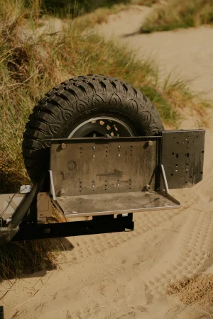

I got a RIG'd Ultraswing for my J250 build. And I love the way it looks. And feels very secure. I believe a 33" tire is the max you can fit in the factory location. I've heard you can fit a 35" tire if you deflate it. But who wants to swap that back on and inflate it again beforehand.

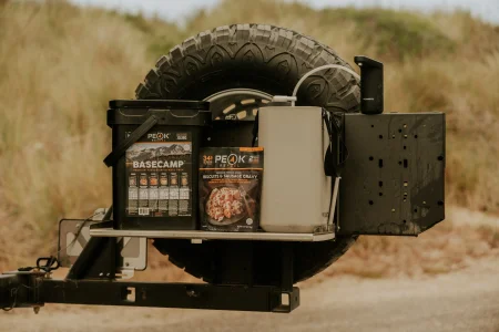

The RIGD has an anti-vibration adjustment inside the hitch. Put a ratchet in there (I think it's a 15mm) and snug that up tight and it makes a huge difference with how much the carrier/tire vibrates when mounted on the back. The table is awesome and the slide out cutting board. I also purchased the side hack which I plan to mount a rotopax and maybe domestic water carrier on. I also bought the SKEP (Hitch Skid) which makes for a great seat, step, and protection when offroading.
The license plate light plugs into the 4 pin on the trailer harness.
The only thing to keep in mind is how weirdly wide the new hitch's are for the new gen platforms. I had to buy a longer hitch pin to fit through and lock into place.
