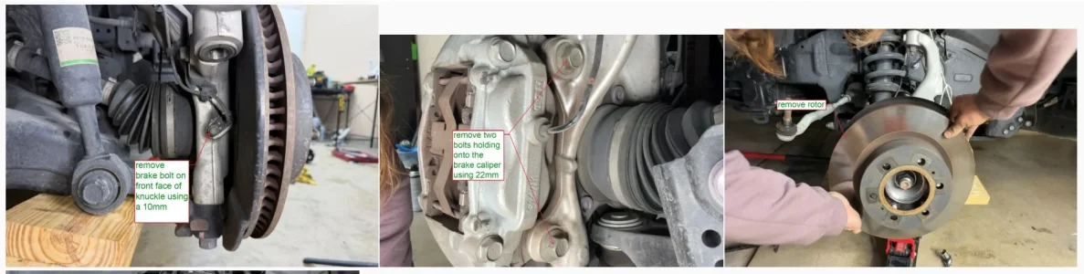

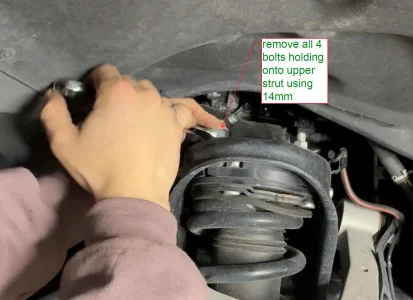

What is up guys, I wanted to put together a simple little walkthrough to help you get the strut off your 250 Land Cruiser. Nothing too crazy, just an easy process that should help make the job way smoother. Steps are below.
You can find a video where I take off and install aftermarket struts here --> Strut Removal
1.webp2.webp7 upper ball.webp8 lower strut.webp9 lower knuckle.webp10 upper strut.webp11 pry bar.webp12 removal.webp
