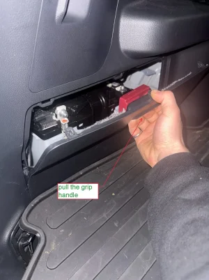

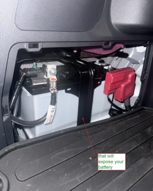

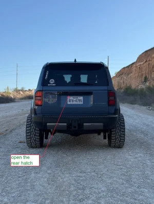

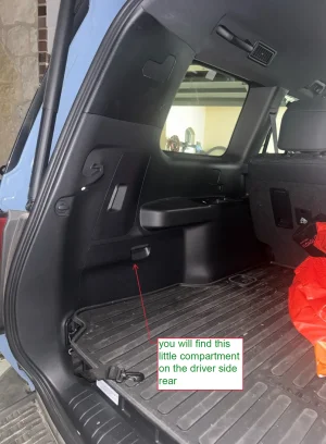

Hey guys, if you are looking for the battery on the 2025 Toyota Land Cruiser and cannot find it under the hood, you are not alone. That was the first place I looked too, and I was pretty confused at first.
On the new Land Cruiser, the battery is actually located in the rear of the vehicle, not under the hood like most people would expect. I figured I would make this quick post to help save someone else the time and confusion.
If you came here looking for the proper jumping points under the hood, check out my other forum here --> Where to Jump a 2025 Toyota Land Cruiser
Below are the pictures showing where the battery is located.
