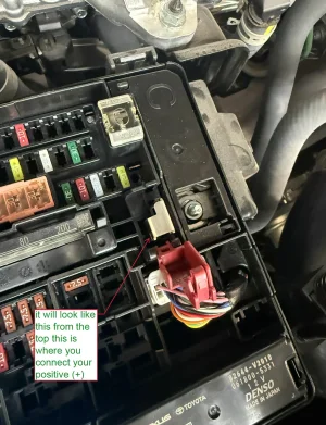

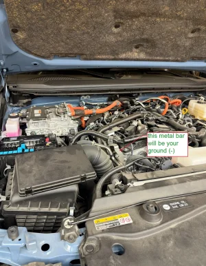

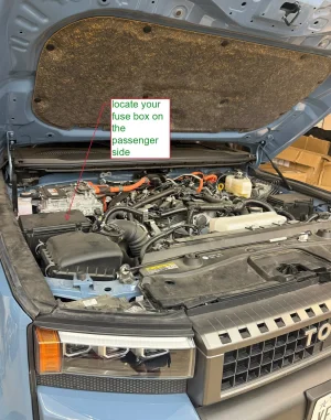

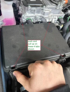

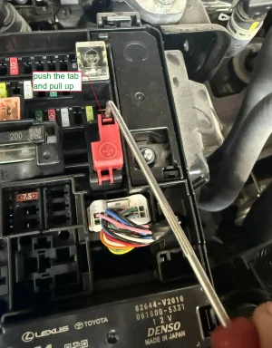

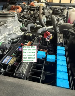

Hey guys, I wanted to make a quick post about the jumping locations on the new Land Cruiser since the battery is not under the hood like most people would expect. This threw me off at first, so I figured it would be helpful to make a simple guide showing where to hook everything up.
If you are trying to figure out where your battery is actually located, refer to this link for a full breakdown on that. --> Where Is the Battery on a 2025 Toyota Land Cruiser?
Below I’ll show the proper jumping locations under the hood.
