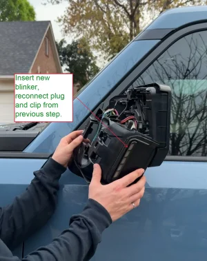

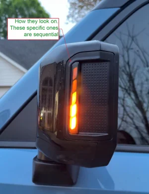

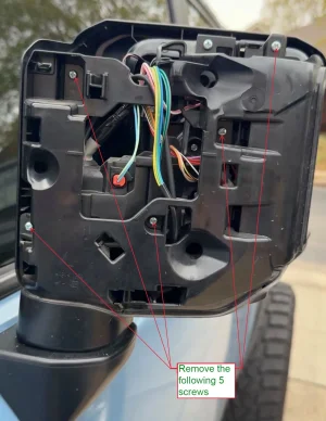

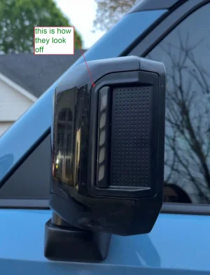

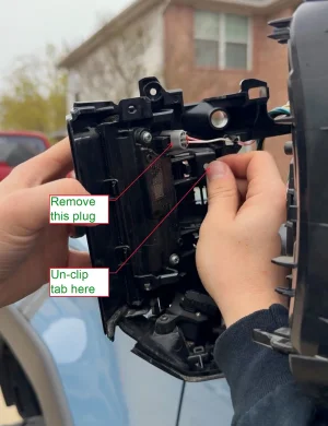

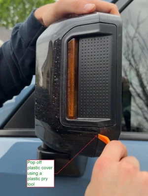

I’ve been wanting to give my Land Cruiser a different vibe, and this little mod totally did the trick. It gave it that subtle standout look I was going for, and I’m so stoked on how it turned out. Install was crazy easy too — only took about 30 minutes. Super clean, super simple, and such a nice touch. Below is how to pull everything off and get it all back on!
Here is a link to my quick install --> Aftermarket Mirror Blinkers — 2024-2026 250 Land Cruiser
plastic tool.webpscrews.webppop off.webpold one off.webpnew one on.webpnew off light.webpfinal on.webp
