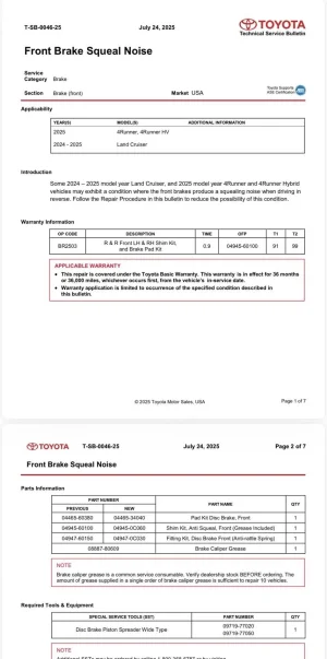

Looks like Toyota has finally made a TSB for the 6th Gen 4Runner and Land Cruiser 250 brake squeal issue that many people have been having. This loud screeching of the brakes comes from the front end of the vehicle typically while having the vehicle in reverse. Check the photo to see the full TSB.
But it looks like Toyota will be replacing front brake pad kits and also the shims under warranty of course.
