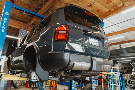

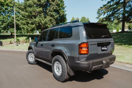

This 2025 Toyota Land Cruiser was upgraded at 8Runner Off-Road with a lift, wheels, and tires to improve stance, clearance, and capability.
  • Westcott Designs Preload Collar Lift: 2.5" front / 0.5" rear for a level stance, added clearance, and proper alignment
  • Fuel Fortress Wheels: 17x8.5 with +25 offset, machined face w/ gloss silver rings
  • Toyo Open Country A/T III Tires: 35x11.50R17 for all-terrain traction and durability
  • Clearance Adjustments: wheel well trimming and extended lug nuts for a clean fit
The result is a taller stance, 35s that hook up on any terrain, and a setup that’s ready for trails without sacrificing drivability.
